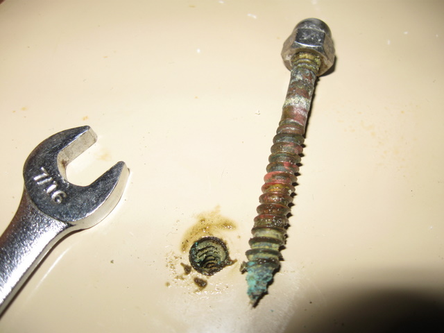

This weekend I installed a new head and had the chance to learn what Bobby told us about these head bolts and how they simply thread into the base. Well....one of my bolt/nut combos was seized up and I ended up backing the entire bolt out of the base to explore. Sure enough the bolt is simply screwed into the head floor. The interesting aspect is that the bolt is a lag screw on the bottom and a machine screw on the top for cap nut. The base seems to be built up on the underside so that these long lag screws can be threaded into the base. With this seized bolt, I simply backed it out, then mounted the head, and screwed it back in. So if your head bolts break off, I guess you could drill new holes and screw down new ones. Has anyone every broken any of these? Has anyone replaced these with new ones? These look like custom screws/bolts. Any idea where they came from?
Here is a photo...

They are called hanger bolts and the come is brass, steel, Stainless Steel, etc in a wide variety of sizes.
I've broken them off and rather than use a screw extractor it is usually easier to just slide the head over enough to mark and drill clean holes and then reinstall using stainless bolts. The original bolts on the boat are brass and they tend to break off fairly easily.
Check out Jamestown distributors or your local hardware store for replacements. Easy to install - after drilling the new hole (or deciding to use the old hole) install two nuts to the threaded part of the bolts. Tighten the two nuts against each other, then use a socket or wrench to screw the lag bolt portion into the floor.

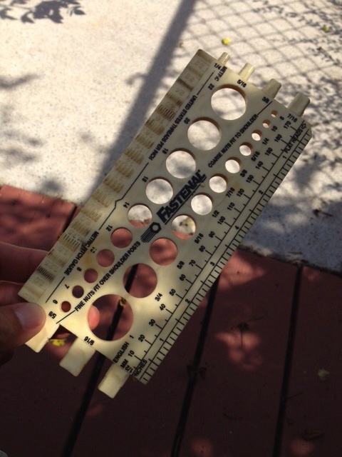

Neil it's possible the fasteners used in the head installation on your boat are different than another's. In situations like sizing fasteners, rigging, etc, you should always do your own measurements. Consider the inexpensive items below, which can be purchased online.
Best of luck and I hope this helps!
12 years 3 months ago #2626 by nscott54
Replied by nscott54 on topic Re: Head Bolts, how they work
Good point. And I do need one of those tools on the boat.
