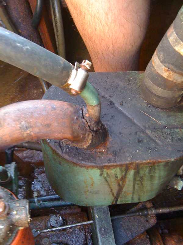

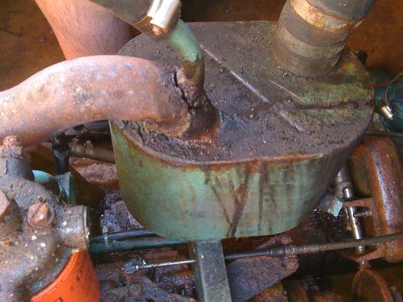

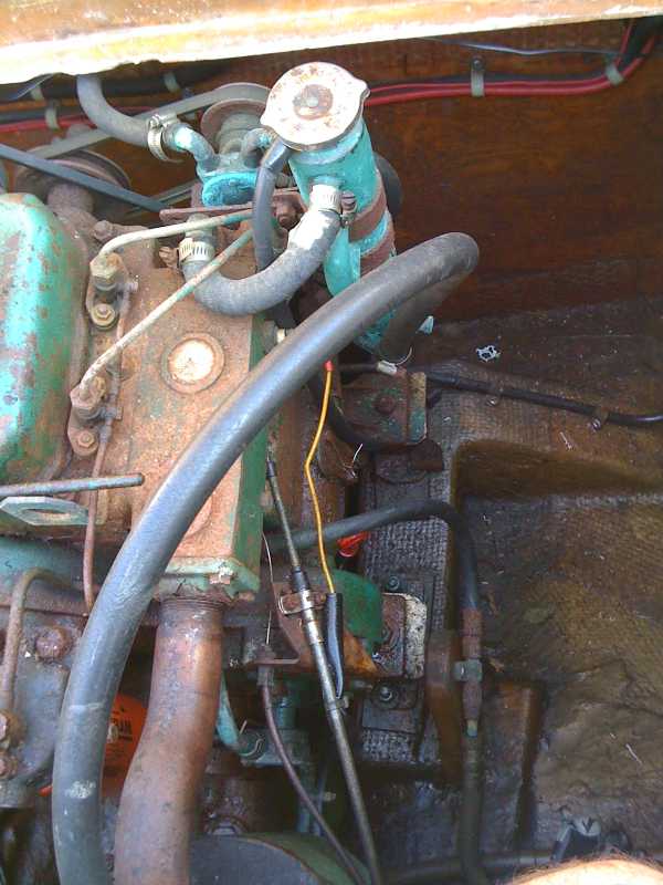

Ive been trying to do some research and Im thinking the heat exchanger is not the problem. Im not sure what this piece is called, but hoping one of you might. Its a Volvo Penta MD7A engine, not a Yanmar. The piece that broke I believe is part of the exhaust system, because when I turn on the engine (I ran it just for a minute to see if I could identify the problem), exhaust and a small amount of water come out of the piece that broke off. From that piece, there is a hose that runs to what I believe is the bottom of the heat exchanger. I took some pictures of the part where the piece broke off, and a picture of where that hose runs. This part is oval and cylindrical and bolts to the engine right above where the propeller shaft comes out of the engine.

14 years 9 months ago - 14 years 9 months ago #1019 by capediver714
Replied by capediver714 on topic Re: Engine overheating! I need answers
Sorry for the small pics, here are better ones.

Does a water-cooled exhaust bend sound right? I havent been able to find one that looks like mine, but I have been searching nonstop and this seems like its the closest thing to mine. Could a crack in this cause the engine to overheat?
